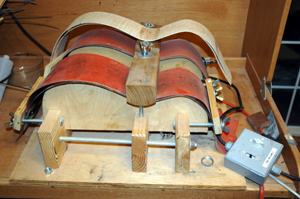

I think the stew mac one was well worth the money. It works great. But I agree my primary bending rig is the machine with the heating blankets. I made a double jig so I can bend two sides at once.

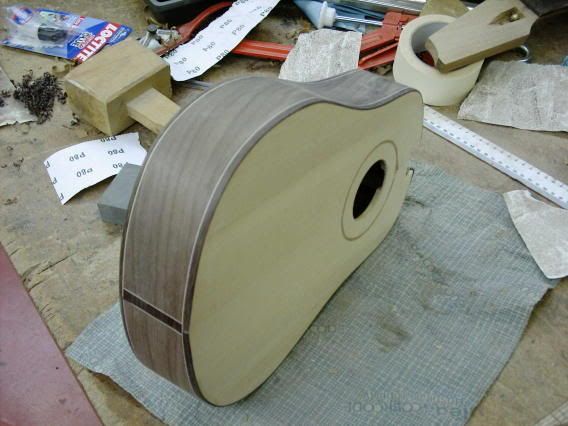

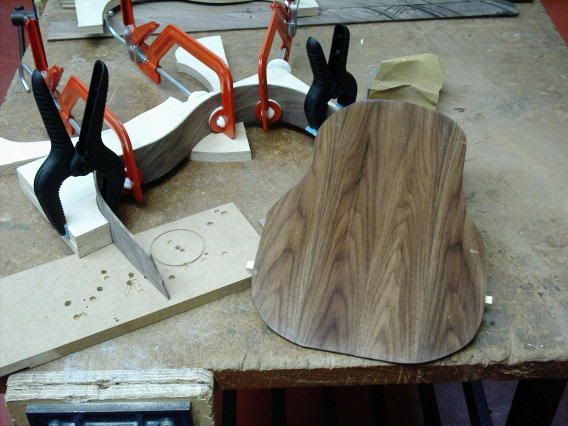

[QUOTE=peterm] Martin, how does the Steam wallpaper stripper work?
Exactly as in the pics above.
steam the sides flat on formica (which holds the heat & moisture well).
Work along the length of the side, turning regularly, then after about 5 minutes spend a minute sliding the steam head along the side so that all of the side his hot & damp, then slam it in the mould & get the clamps on!!
for binding I did the same, then dried it off and worked it ino the step, taping it as I went.
REALLY handy, and a FAR neater fit than my previous attempt bending on a hot air paint stripper.

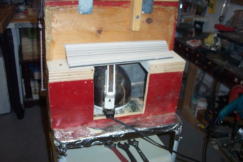

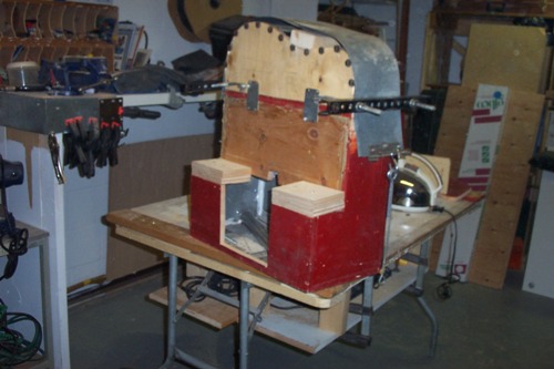

Martin, i was in the same situation last year and used a kettle and steam chamber to bend my sides! Here's 2 pics of my first and now former bender, while it was in the making! I can relate.
